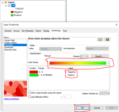

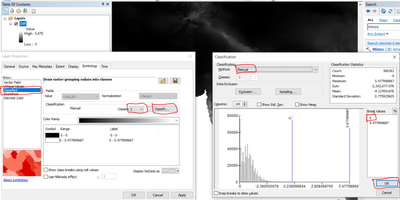

I am working with ArcGIS 10.6. I have used the minus spatial analyst tool to subtract two separate DEMs. The output raster comes out fine, but I am wondering if there is a way to render the output raster to show the positive and negative differences between the two input rasters instead of just showing the normal black and white shading?

I assume you are using ArcMap.
Using Layer Properties > Symbology

LaurenWeilert
It worked! Thank you so much!
