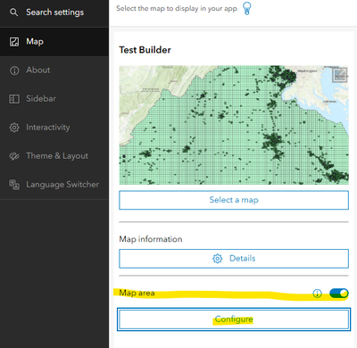

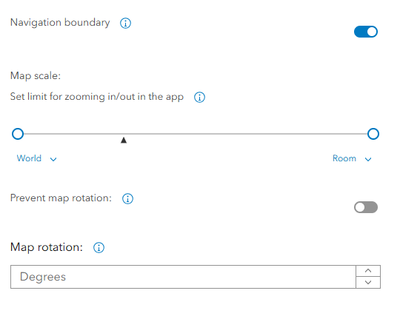

RussRoberts
Esri Notable Contributor
Click on the map tab under "search settings" and click the enable map area
Then make sure to enable this navigation boundary on the right hand side of that full page configure view that opens. This will then let you control the scale along with extents.

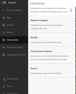

SaraWazir
Forgive me if its right in my face and I cant see it but I have turned off Express mode and I still cannot locate the configuration settings for establishing a navigation boundary (See my screenshot below for what it looks like at my end):
RussRoberts
SaraWazir
awesome, thank you, this is super helpful. I was able to find the configuration tool.
