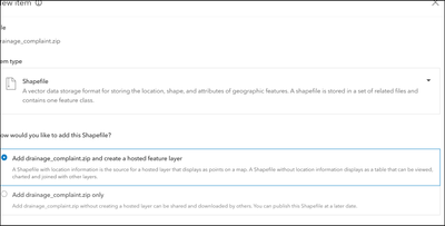

As it says in the screenshot, if you upload a .zip of a shapefile and don't choose the convert option, you can go to that item later and hit the "Publish" button and it will convert it to hosted feature layer.
