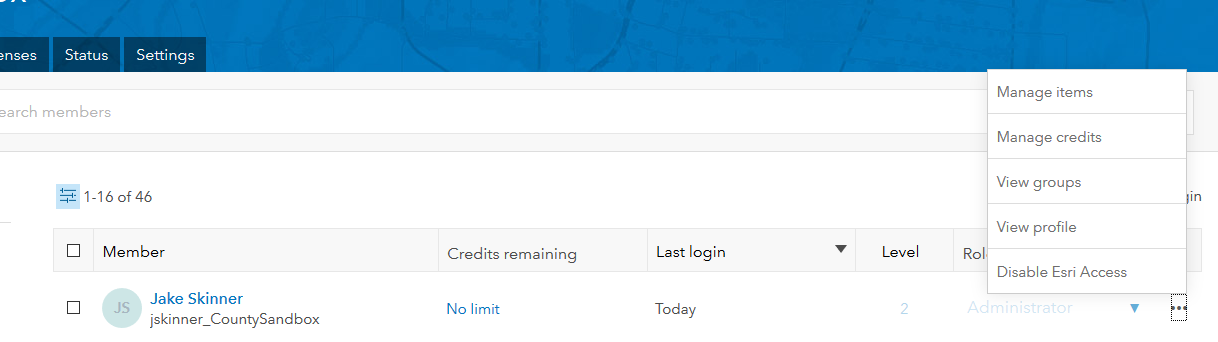

Hi Armando,
Within ArcGIS Online, go to Organization > Members tab.  Click the 3 dot button next to your account and you should see an option to Enable Esri Access:
