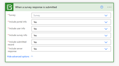

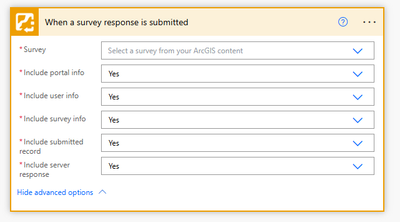

They both seems to have the same parameters.  Here is the ArcGIS Connector one:
And the Survey123 connector one:

I inquired with support, and the response is that the MS Power Automate Survey123 connector, triggers, and actions will be deprecated and no further development is occurring on those.  They are being replaced with the ArcGIS Connector, triggers, and actions.  No date as of yet for the deprecation, but it would be a good idea to start migrating any flows to the ArcGIS connector, triggers and actions.

CalvinHarmin
Hm that is interesting that they are deprecating the Survey123 Connectors/Actions. Currently, Survey123 actions do not require a Power Automate premium license, while ArcGIS actions do.
