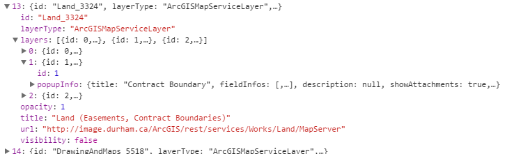

I'm trying to create a URL to open a webmap to a specific feature.  After doing some reading I have most of it figured out, but I am just missing some details.  The feature I am trying to search is in a group of layers in the map.  The group of layers is id:  Land_3324
and the actual layer I want to search is id: 1
I just cannot get the URL syntax correct, and cannot find any info online.  I have tried the following with no success:
