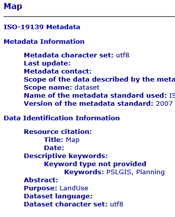

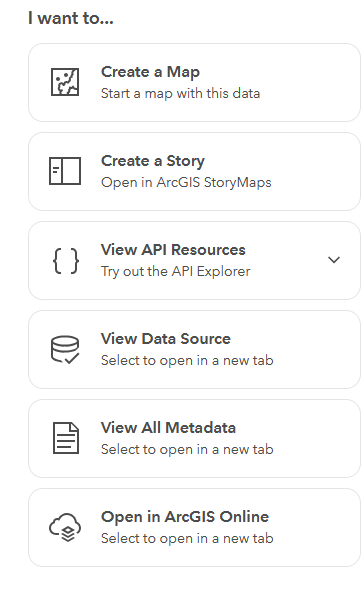

Getting a little frustrated here. I have an open data portal that I want to have users click the Metadata button and see the metadata.

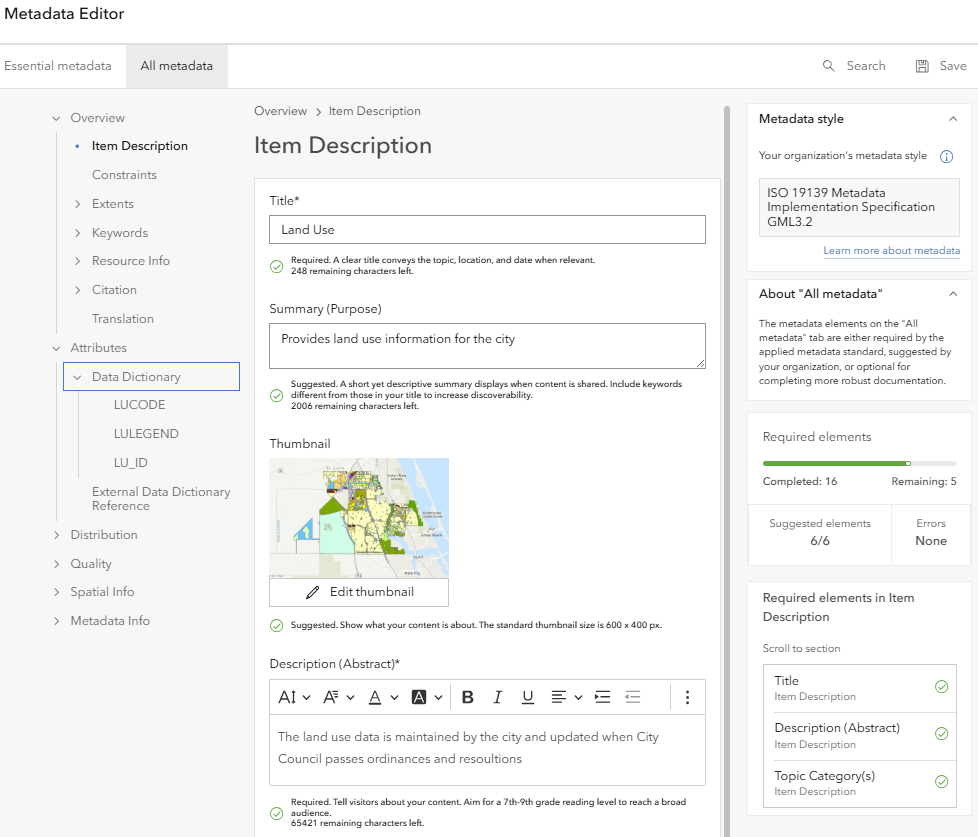

I have enabled metadata for our organization and in the feature service I have added metadata.
But when I go to the metadata button in the open data portal, nothing has been changed.

What I found was that only the metadata on the main hosted feature service is shown. It does not seem to work by editing the sub layers.
