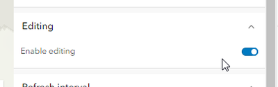

Plus the "enable editing" option is not present in the properties.
The feature layer containing all these tables and layer has editing enabled.

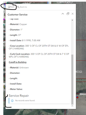

Service Repair/Work is my related table

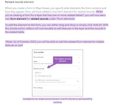

Once I click Edit it is set up to how I made it look within the smart forms. Have you configured your smart form and added the related records there?

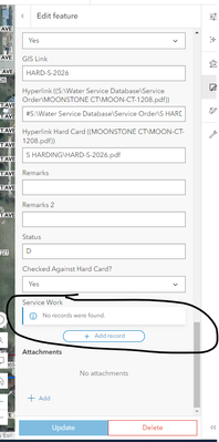

I can edit a related table in the corresponding layer popup. Once I click edit in the popup it takes you to the right side pane where there I can add & edit the related table at the bottom. You need to click edit on the initial popup. You don't need to click into the related data and then click edit. The related table data should be at the bottom of the same edit pane they use for the points.
mikaël
Hey Laura,

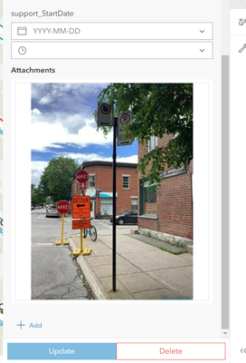

If I click on a feature in the map on the point layer, I get the popup where I can click edit, and as you said, the edit pane on the right side shows up. However I only see fields for the point layer, not related tables.
At the top there is a small "Settings" section, then all the fields where I can change values (in the point layer), attachments (pictures) at the end and then the possibility to "+ Add" a feature through a file. Finally at the bottom, buttons "Update" and "Delete".

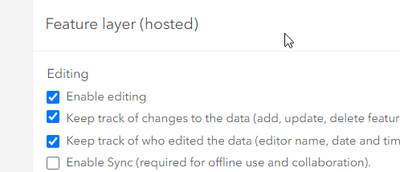

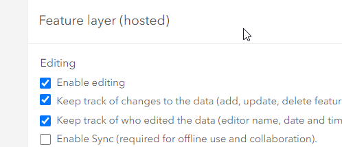

I noticed in my previous screenshot that there is a message saying "Editing is disabled but you have privileges to edit this layer". I don't know where this is coming from because editing is enabled in the feature layer properties.

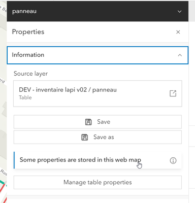

I searched in the map and found this in the layer/table properties:

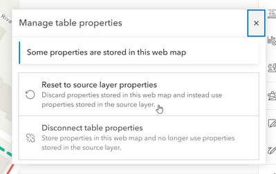

I saw then "Some properties are stored in this web map", clicked on it and this is what pop-uped:
I thought maybe the problem was that "Pop-ups and attributes" were stored in the web map.
So I tried to "Reset to source layer properties"
But this basically removed all my layers and tables. I added them back and tried again to edit, but same problem and then the properties are stored in the web map again.
So this did not work.

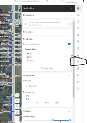

mikaël
I did NOT configure smart forms!! Just used related tables and values generated from Survey123 forms.
Gotta do a couple of things first and then will try it out.
Will report back with status, I'm sure this is the problem.
Thanks Laura!
mikaël
Problem solved!
Thank you @Laura, your solution did the trick !

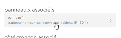

  1. When I click edit on the popup of my layer and then click on related records, I get to the related children records table. But then I can't go back to the parent layer. I have to exit the edit pane.
  2. My layer actually consists of children records from a parent table. I can't seem to enter edit mode for this parent table. The relationship options in Smart Forms seem to only be from parent to children, not "backwards".

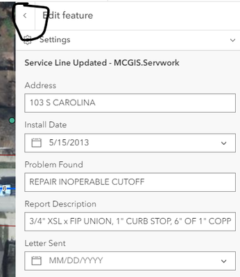

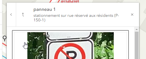

There is a way in EXB & map viewer by using this arrow
mikaël
Yeah when I click edit in a popup for a selected feature, then click on a related feature, then click on that top left arrow, it brings back to the the basic edit pane like when no feature is selected, doesn't bring me back to the parent layer. I'll contact ESRI.
