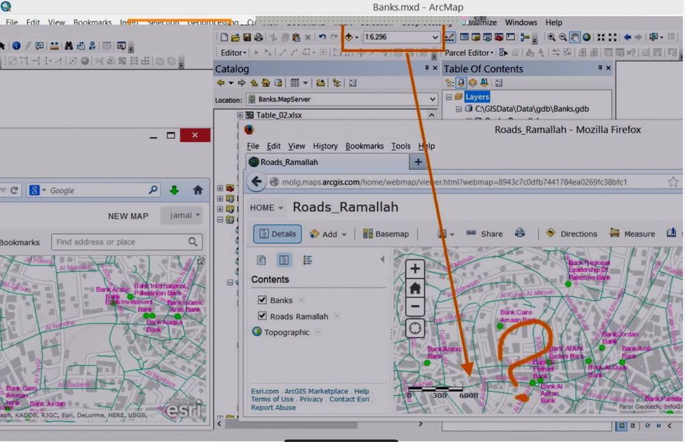

I???m wondering if there is a way to show the map scale in the ArcGIS Online.
[ATTACH=CONFIG]31488[/ATTACH]
Thank you

I don't believe that you can do this
however go to
ideas.arcgis.com
You can then post this as an idea and you never know it may become part of a the service in an updated build

Map scale, contrary to a scale bar, has one difficult aspect to it regarding web application or screen display in general: it becomes screen ppi (pixels per inch) depended. E.g. the same 1000x1000 pixel image depicting the same 1x1 km area on the earth's surface can have vastly different sizes on different screens with different ppi resolution, and since there is a plethora out there, this is a major issue. This is especially apparent with all the new modern "retina" type resolution screens.
Map scale only really has usage for printed output in this respect... and if you haven't told ArcGIS for Desktop what your screens' size is through the Advanced ArcMap Settings utility, the settings for "scale" can be way off in ArcGIS for Desktop.
