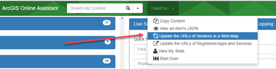

You can use ArcGIS Online Assistant to update the URLs of the services used in the map(s).
Haven't tested this to see if it keeps all the popups, labels, etc. but you can change the layer id's as well in the URL here.
R_
EmersonCardenasSachica
Thanks RhettZufelt ... this solved my problem with the MAP and save me to remake symbology colors!!!... i'm so happy!!
