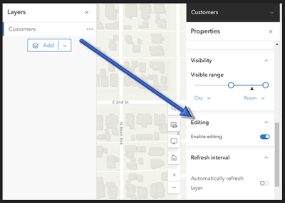

Hi @Kevin_MacLeod
Yes, as you discovered, forms enable you to set editability on a per field basis. To prevent editing for all fields with 1 click, you could just turn off editing for the layer in the Properties pane.
Note: Changing editing settings in the map doesn’t affect the editing settings for the layer itself, the settings only apply to that particular map.

EmilyGeo
Hi @Kevin_MacLeod
