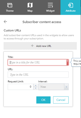

Hello Will,
Which web app are you using?  There is a way to configure usage of subscriber content in the Web App Builder app.  See attached screenshot
