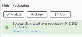

I created a Layer Package in Pro and shared it to my content, and then added it to a preexisting AGOL map.
It added to my map - but the symbology I created in Pro was not maintained. No big deal, I can at least change the color to distinguish it from another point layer, right? No. I get this when I try to edit the style:

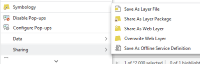

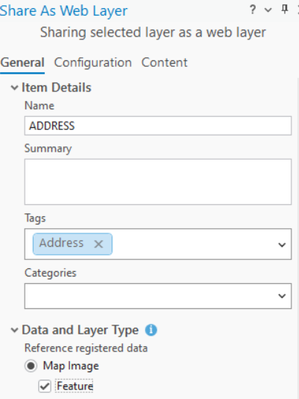

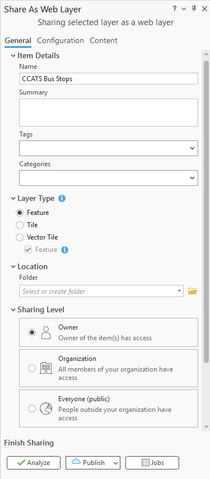

In your Arc Pro map, right-click on the layer you want to publish. Go to Sharing, then Share As Web Layer.
This will open the geoprocessing tool where you can give it a Name, Summary, Tags, Categories, specify the Layer Type, where to store it on AGOL, and the Sharing Level if you want others in your organization to see it.
Once it's published, you can bring that layer back into your Arc Pro and make edits to the data without needing to republish.
This is how I have created layers in a web map with the specific symbology I wanted, then updated that data.

If you right click on the layer in the map, go to sharing, and then share as web layer, you should be able to publish just one:

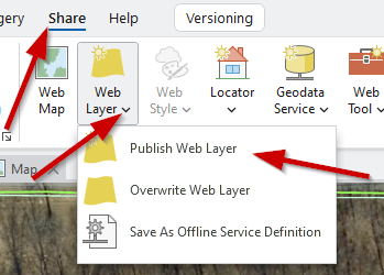

Thanks for chiming in! So, that was what I would have liked to do, and what I tried in the first place, but that publishes the whole map as a web layer, as opposed to just the one layer I'm interested in. Maybe I'm missing something obvious there, but I couldn't figure out a way to get it to just publish the one or two layers. I guess I just need to put the one or two layers I'm interested in in their own map and publish that as web layer.
Or I guess I can Overwrite Web Layer with all of the layers together. It just gets complicated, as I perform additional analyses and whatnot I get extra layers in the map that I don't necessarily want to publish online, but I don't want to remove them from the map either, because I want to be able to continue to work with them or check things, etc. And then I end up saving these multiple versions of Pro maps, so some are all pretty and public-facing and others are messier and allow me to see my work, etc. I'd like to just be able to select the specific layers I want to publish as Web Layer but I haven't figured that out.

Well, the problem was that I am an idiot and I was missing something obvious!!! I know I had looked at the right click options from the specific layers I wanted to publish before, and yet somehow I missed seeing it as an option there. I kept trying to do it from the Sharing ribbon at the top of the app. Thanks to you both!!!
