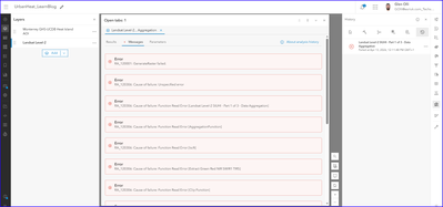

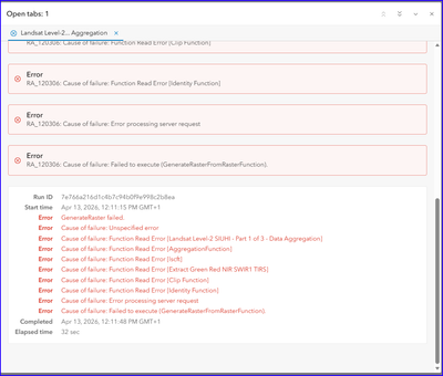

GlenterpriseUK
Hi @JamesSill,
@MohdNassif has already added the errors above in his post but I am attaching them underneath after trying in house:
Regards,
Glen
JamesSill
Thank you for providing the Screenshots.  When prepping the input layer (the Landsat Level-2 Image Service), you will need to set the default Raster Function Template to "None".  This is done using the Raster Function tab on the right hand side of the Web Map.  Setting the default Raster Function Template to None exposes all the bands needed for the aggregation step.
