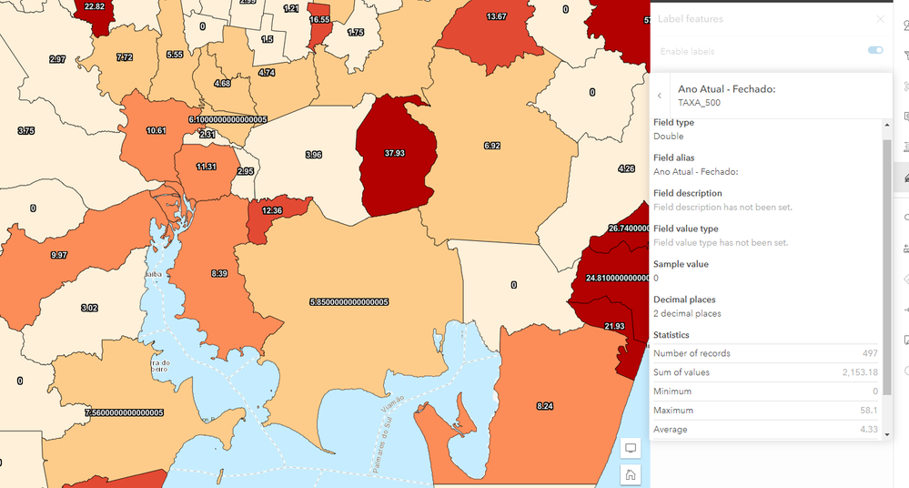

Hello,
I don't know why I'm getting this weird behavior on the layer labels. In our database this attribute only contains 2 decimal places.
Any idea how to fix this?

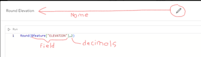

I figured it out... still kind of new to map viewer.  This thread is several months old but I'll post the solution in case someone else like me comes along looking for an answer.
You have to use an expression to round the labels:
1) click the expression button next to the Label field drop down
2) use the Round function to specify the field and number of decimal places to round to. You can give your expression a name too.
