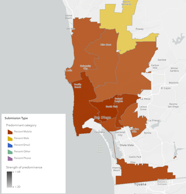

Hi there, I'm enjoying the Predominant Category symbology style available in ArcGIS Online, however I am  finding it difficult to label the results I am showing. I want to show the predominant category + value as labels in the map. It would be great if the result automatically became available as a label when using this style.
But since it's not...
When I bring the map into ArcGIS Pro, I can see the Arcade snippet driving the symbology, but I am not good enough with Arcade to adapt it to show me the predominant category + value as a label. Using maxValueField only gives me the predominant field... anyone have suggestions to return the value as well?

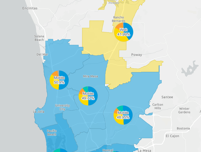

I was able to do this and am posting the (very simple...) solution to return the predominant label and value in case it helps someone else.
It's a simple return of the maxValueField and the maxValue. In my example above I am using
return Mid(maxValueField, 2) + TextFormatting.NewLine + maxValue + '%';

I was also looking up on predominance mapping in AGOL and had followed this blog post creating the arcade syntax.  A couple of questions for you, is the map above with the pie charts symbols in AGOL or Pro? I really like being able to easily see the breakdown you are showing with all the slices. When I looked up I think pie chart symbology is not yet supported in AGOL?
