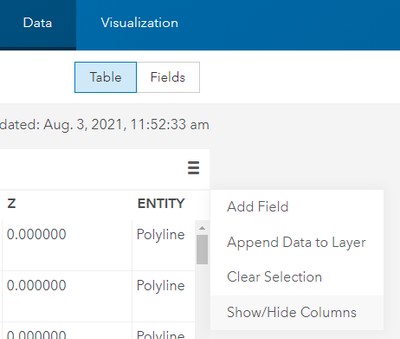

You can hide fields on the table on the map, but I found that when I shared the map the people could still see them. If there is another easier way please keep me posted. I would love to use it.
vkosti_4Dglobal
Exactly, hiding fields from the table on the map does not turn them invisible to the public - Neither from the Data tab > Show/Hide fields option. I believe that this was the setting that I used in the past but now does not function as I would like. If I found out, will let you know. Thank you again!
