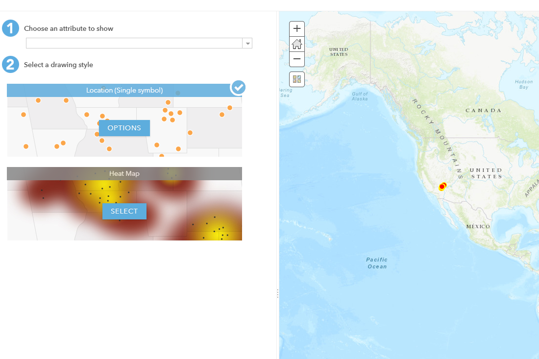

I have a point layer added to a web map and I want to change the symbology and color code it by attributes. Under step 1 "Choose an attribute to show" the drop-down is blank/empty. No fields to choose from. I can not proceed to step 2 "Select a drawing style" with nothing selected in step 1. The only work around seems to be turning off most of my fields before going into the change drawing style menu.
It seems AGOL can only handle a certain number of fields in a layer to generate the attribute list before it fails. Does anyone know what that limit is?

AdamDaily
I have tried clearing the cache, different browsers, and machines. Same result every way.
This particular layer is huge, nearly 500 fields. I certainly don't need many of those and turning off fields can work. But, it this is a known limitation and the only way to edit layer symbology in a web map, it would be nice to see a mention of that in the documentation and to know what the magic cutoff number is. 20, 50, 200, etc. With layers this big, its a lot of time deciding what fields to keep and turn off and then going back and forth wondering if the drop down menu will work now.
