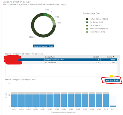

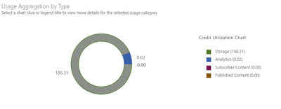

@HealthyGulfGISAccount  - The story map most likely would be linked a webmap that is associated to a feature layer. Have a look at the size of the feature layer to begin with. Sizeable feature layers will consume credits rapidly. You might also want to check if there are any geoprocessing operations taking place within the organization as they may be consuming the credits as well.
Rule of thumb - Feature Storage (i.e Feature layer) uses the most credit.
Attachments/Pictures use substantially less credit.
Storage (GDB, excel files, etc) use the least credit

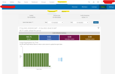

I would recommend using the Report Functionality to view Credit Usage.
You can find this under Organization -> Status -> Use the "Dashboard" or Generate a "Report"
I prefer using the dashboard.
When generating a Report
Select "Create Report" -> "Single Report" -> Report Type = "Credit"
Note - this is a user centric credit usage report.
