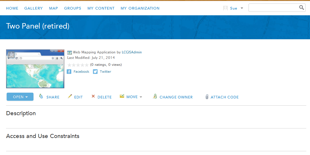

Sue you don't need to create a new item. Just go to the item page for the existing item and click Share and share it with the group you set up.

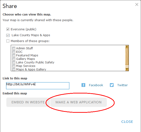

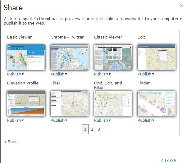

When you Share an AGO map you have the option to Make a Web Application:
Not all the templates that have been available in the past are now available directly like above.  But I found a web page that lists all of them - including the retired ones at http://www.arcgis.com/home/search.html?q=templates&t=content&start=91

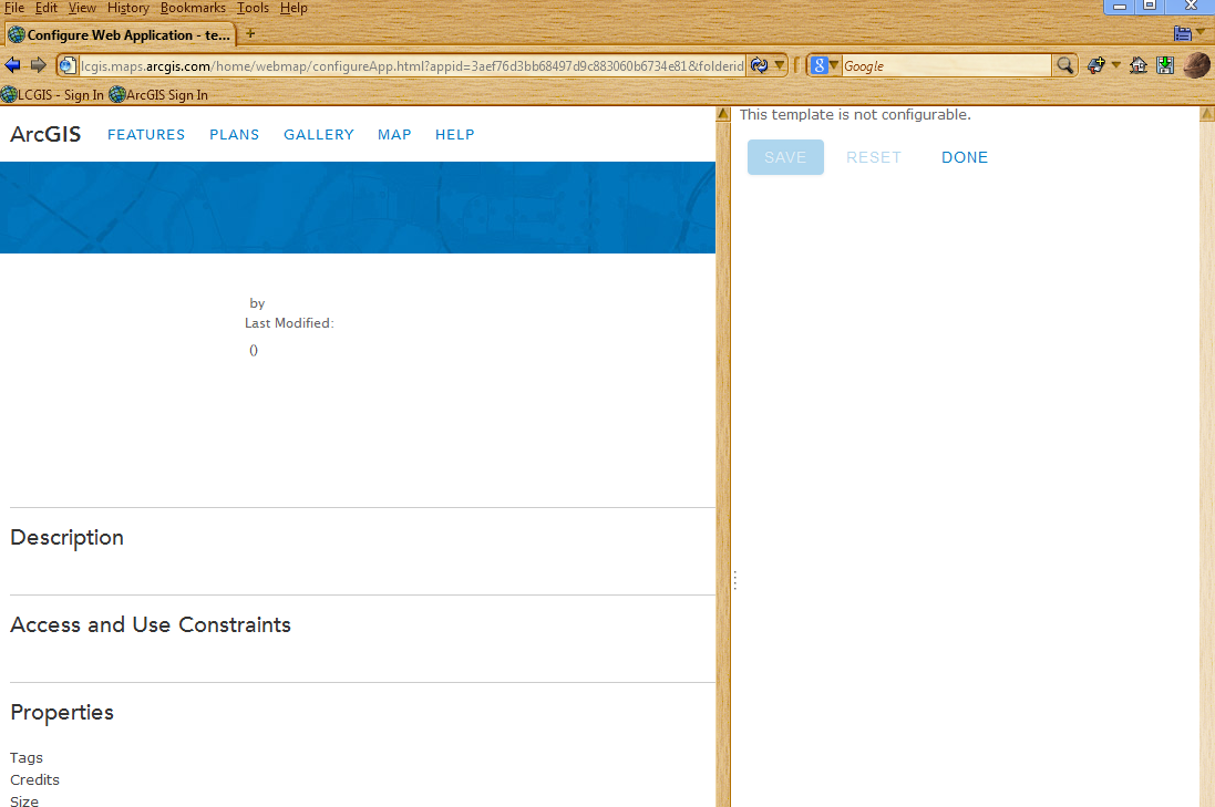

Your response allows me to add the retired templates into my group and designate that group as a template group, but I still can't USE the template - it says it's not configurable.
When I try to Publish it, it says This template is not configurable.
Am I missing a step?  I don't want to "host" the app on my server and access it as a template.  I want to actually USE the template hosted on the AGO server like the non-retired ones.

That's the same retired template I used without success. It's just not configurable for me.  I even tried another template - the two panel (retired) at
http://www.arcgis.com/home/item.html?id=5766ba5eaddc4d48a41ae086b8a2f122
with the same results.  It is not configurable.
