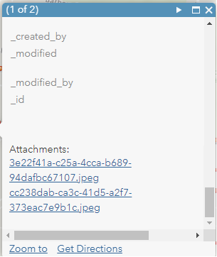

The way ESRI online handles it is that it just groups all attachment together under attachments in the pop-up.
Is it possible to group the photos separately?
