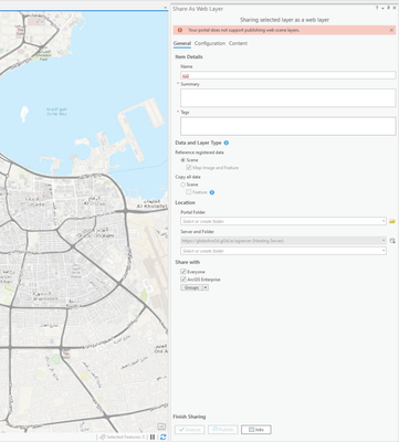

When I try to publish a building web scene to my local portal (using ArcPro 2.5) I get the following error:
"Your portal does not support publishing web scene layers."  Also, see screenshot below.

Hi,
Which version of portal are you running? If you have an older portal it may not support all scene layer types. This doc specifies which scene layer type is supported with which portal version.

PDSGIS_Department
Andrew-
We are using Enterprise Portal 10.6.1. Looking at the chart, it looks like Building Scene layers are the only thing we can NOT publish. We will have to look into upgrading to 10.7 or later.

Hi
I am also facing the similar issue. I have logged into administrator account and few hours back i published the scene from enterprise and suddenly it started showing error "Your portal does not support publishing web scene layers."  Also, see screenshot below.
