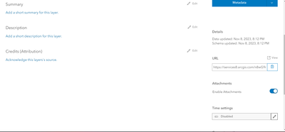

From layer's item detail page, you can 'Enable Attachment':

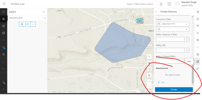

Once enabled, while editing (creating new feature or updating existing) you'll see option to add 'Attachment' to a feature:
