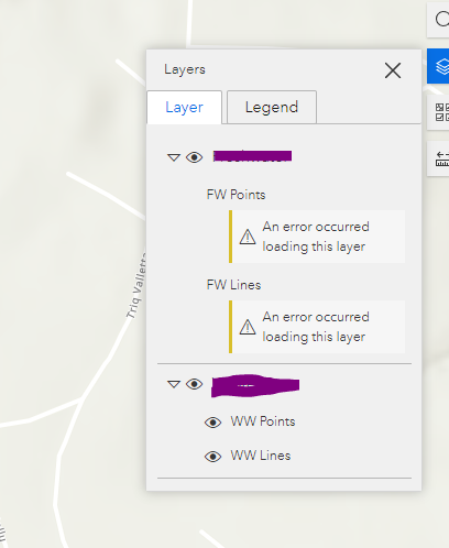

My goal is to have one Application that I can access even if I have permission to view only one layer out of many, but if I have access only to one layer, every time I load the page again, I am asked to log in.
I have a web viewer and an app created with Experience Builder where I added two FeatureServices.
Each of these FSs is shared in one group each.
Let's say I share FC1 to Group1 and FC2 with Group 2, different user have access to one of these groups.
The Map viewer and the WebApp are shared with both groups.
When I login with an user account that is member of all groups, the viewer shows everything correctly.
When I login with an user account that has access to one group only, I see that the layer that is not shared gives an error (an error occurred loading this layer) ---> I was expecting this and I can live with this error.
The problem is that every time that I access this Web Application or every time that I load the page again, I am asked to login, after that, I have access to the map.
would like to have a seamless behavior. Any thoughts about a possible workaround?

The short answer is "no", unfortunately. The way you're configuring things, that prompt is always going to show up.
I have seen users in this situation use some automation to keep two nearly identical apps in sync with one another. Imagine you have one app / map designated as the "primary" ones, the others as "secondary". When you make an edit to the first map or app, a script can copy out the JSON, alter the layer ID, and push the altered JSON to the corresponding secondary item.
It's a bit of technical work to set up, but it would get around the login prompt.
