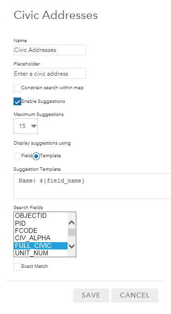

I'm working on a simple Info Lookup template app in which the user can enter a civic number and suggestions are returned to allow the user to select the address they want.  Once an address is selected, the display zooms to the location and a popup from another layer is displayed. I am using an open data source, and rather than using a true geocoder (which pulls information from multiple datasets) to allow the user to find a specific location, I only want the user to get results from the single data source, Civic Addresses.  The ability to do that is part of the functionality of the Search tab in this template, which is great, but it is not usable for my purposes based on the default settings.  The user must be able to see multiple values in the list of suggestions when entering a civic value.  I cannot figure out the syntax for displaying values from more than one field in the Suggestion Template, as shown in the graphic below, and I've not been able to find any reference for this.  The dataset I'm using is https://services2.arcgis.com/11XBiaBYA9Ep0yNJ/arcgis/rest/services/CivicAddresses/FeatureServer/0 and the fields I want to display in the suggestions are: FULL_CIVIC, Street Name, Street Type, Community Name.  Any suggestions would be much appreciated!

OK, we've answered the question in-house:  putting commas between string values allows the values to show up in the suggestion list:
CIVIC:  ${FULL_CIVIC}, ${STR_NAME}, ${STR_TYPE}
That's helpful, but it also revealed that this search tool cannot be used to search on values from more than one field.  Entering "2" in the search returns every civic number with the digit "2" in the FULL_CIVIC value, and there is no way to allow the user to add the street name to the query to further restrict the selection.  In short, what we take for granted in Desktop cannot be done here:  an attribute query using more than one field.  I guess we're back to creating a geocoder... unless someone has any suggestions on how to make this work.  Feedback welcome!
