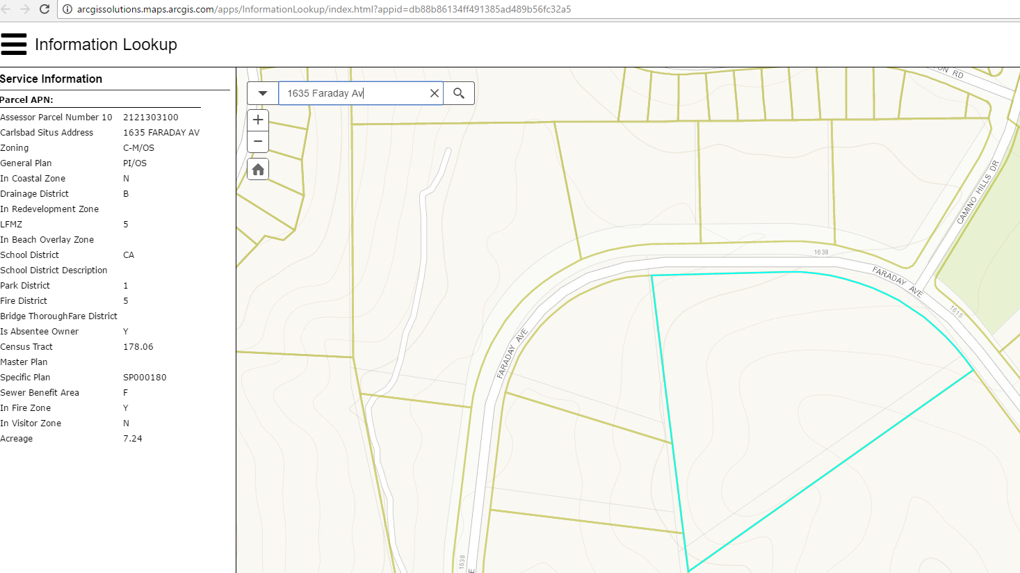

I'm trying to configure the hosted Information lookup app with my data. Im searching for an address against my parcel layer, and I have configured the app to show the popup in the side panel.
For some reason,  the search window is not getting fully populated with the address that I select from the suggestion list. I believe this is also causing the issue with the information panel returning more than one record. A 30 minute configuration is taking me days as I try to figure the issue with my configuration.
Has anyone else run into this issue?
Here's the map if you want to see the issue... , Information Lookup
Thanks in advance!
Please see my attached image.

I cleared out the "search by layer" setting, but I am still getting the multiple results in the info panel. I have the same parcel layer in my web service. Parcel Boundary is visible, Parcel-Address is the same layer, but turned off and used for the search. This is my web service eZoningAGO (FeatureServer)
JuneAcosta
Michael-
Use  "1635 Faraday Av" as the address to search.

Is this what you are after?
Information Lookup
The animation is just an animated gif, I use camtasia
JuneAcosta
Why does it return 2 records? and the real issue is that "1635 Faraday" is listed at the bottom. I would like it to return 1 record or at best return the selected address at the top of the info window.

Maybe a screen shot would help.  Are you getting two results in the panel or in the locator?
MikeMillerGIS
Esri Frequent Contributor
Ok, I was able to repo it, only on the first time searching for the item though.  We will look into it.  You could use the parcel point for the search by layer and then the parcel in the lookup layer.  This is a workaround for this issue.
