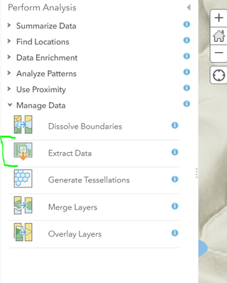

So, I've honestly never used this tool because I use Pro for this type of work, but there is an Extract Data widget that you can probably use?

MuneebAfzal
I will give this a try today. In my mind I am thinking:
1. Create 1km Buffers around each point (dissolved)
2. Try the Extract Data on this newly created Buffer layer to see if possible to extract the list of points that do not intersect with any other buffers. (now that I type it out I am not sure how but I will give it a go).
Thank you Katherine for your help so far.
