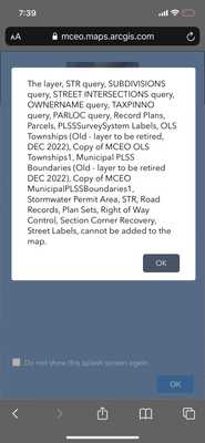

Yes, it is still occurring.
I noticed around 3pm EST that all services hosted on our server (ArcGIS Server Manager) were unavailable. Only feature services hosted on AGOL online stayed available.
Before I left work I confirmed that the services on ArcGIS server manager were up and running. Nothing seemed off.
A ‘blank’ base map is displayed until a message eventually pops up that says the layers cannot be added to the map.
Unfortunately I won’t be able to troubleshoot further until Monday. No real idea if the issue is on our end or not. I wasn’t making any major changes to anything at the time.
