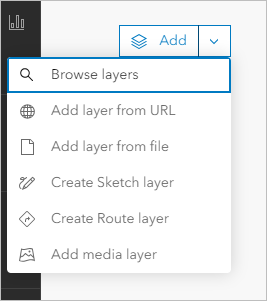

Hello! When I try to add a layer, it gives me four choices, not five. They are:
from URL
sketch
route
media
This is my new account; when I took a course, my educational account had the add from file option. There is no option to add from a file, from my computer! Please advise, thank you.
BobBooth1
Hi Anna,
You need to log in with an ArcGIS organization account to see the option to add a layer from a file.
If you are logged out, you'll see:
and if you are logged in with an ArcGIS organization account, you'll see this:
If you logged in with a free public account, you will not have the option to add a layer from a file.
