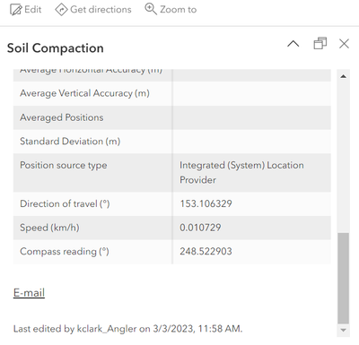

Heh, well now I'm determined to solve this because it should be possible! I've circled all the areas to click to get to that interface in the screenshots below...
After adding the HTML we've discussed above, the pop-up looks like this, with both the email link and the attributes showing.

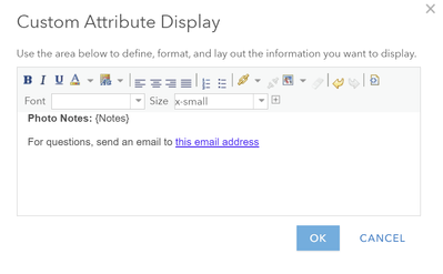

In map viewer classic, you can customize the entire pop-up using HTML, so you can use an <a href> tag to create the email link.
Here's an example of what the pop-up could look like. Attributes will populate where the field name is in curly brackets.

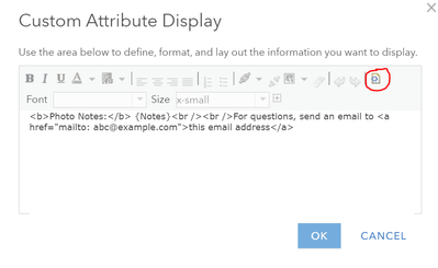

This is what the HTML looks like for that display.
Does that work for what you need?

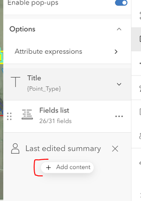

In the new map viewer, you click "Add Content" > "Text" under pop-up configurations to add custom HTML. If you don't want the default field list/pop-up format to display, delete the Field List section from the pop-up configuration menu.
