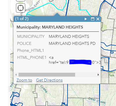

I am working on creating a hyperlink by configuring the popup through Attribute Expressions. The purpose is to create a telephone call link for all of the Municipalities. I have all of the numbers for all of the police departments and want to insert them into some HTML text which will be populated by creating a virtual field in Attribute Expressions.
When I have the full HTML in the field, the hyperlink is created, but when I write out the code by using Attribute Expressions below the HTML text just shows up with no link.

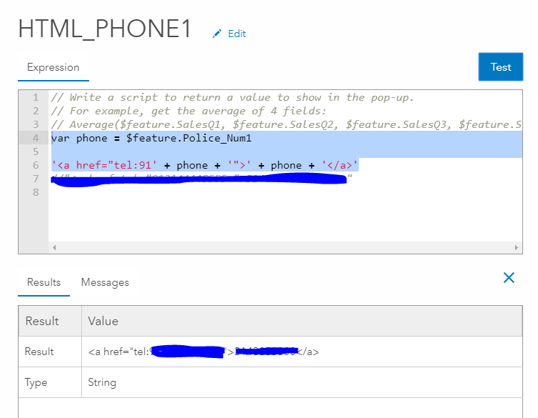

      var phone = $feature.Police_Num1
      '<a href="tel:91' + phone + '">' + phone + '</a>'

Hi Walter,
An Arcade expression just returns a value (in this case, a string containing HTML). The software receiving that value (in this case, ArcGIS Online's Map Viewer) is then in control of what happens with that value. The string value returned by the Arcade expression is getting "escaped" by the Map Viewer, to ensure that the value displayed in the popup is the same as the original string value. AFAIK, there's no way to tell Map Viewer that it should interpret the string returned by the Arcade expression as HTML (and that might present a security risk, anyway).
If you want to keep the look/feel of the default “list of attributes” display and still get the hyperlink, you can create a Custom Attribute Display that mimics the default “list of attributes” display, then tweak the custom display in the HTML editor, so it uses the string returned from the Arcade expression as the URL for an <a> tag. For example, check the Custom Attribute Display editor's HTML view in this sample:
