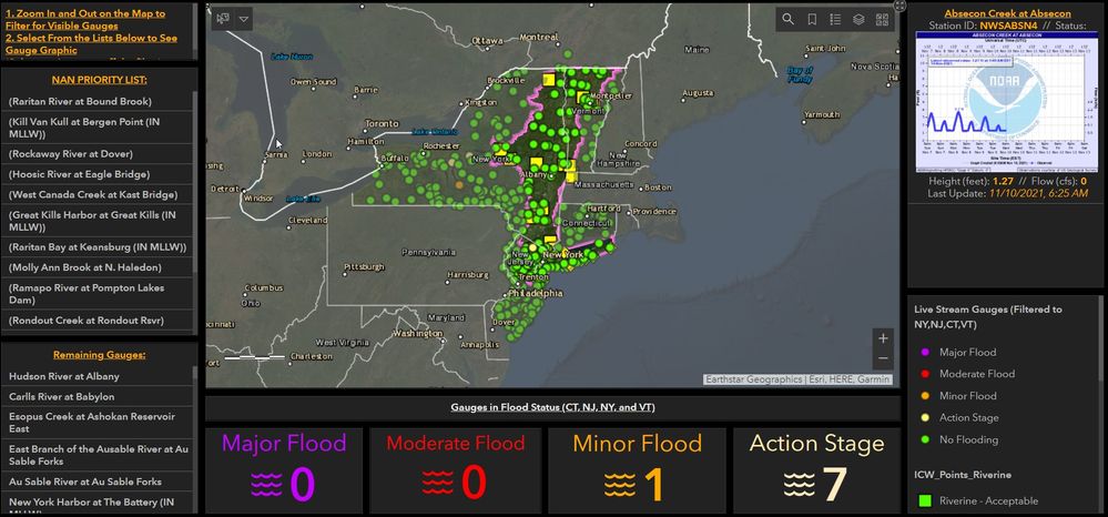

Thanks for the input! I'm trying your first suggestion though am getting a "SpatialReference" error which I'll have to dig into. The second two options you put forward I already did to create the Reference layer (it is used to narrow down the two List elements in my Dashboard to only show those in the area we are interested in). Here is a screenshot of the Dashboard:Dashboard_Screenshot.jpg
In the above screenshot the one "Minor Flood" indicator is showing outside of our AOI. I'm hoping to either limit the points in the map itself to our AOI (right now they are only filtered by State), or limit the indicator to the points within our AOI. (Uploading another feature service as a reference layer negates the live updates from the ESRI Live Stream Gauges hosted feature service; I can use it as a reference layer but I need to narrow down the Live layer itself so we can get continuous updates, especially during storm events).
In the Portal Map that is the basis for this Dashboard I tried manually filtering by stations, but there seemed to be an error where it won't hold more than 125 filters at once (my AOI has 500+ gauges)
Does this help?
