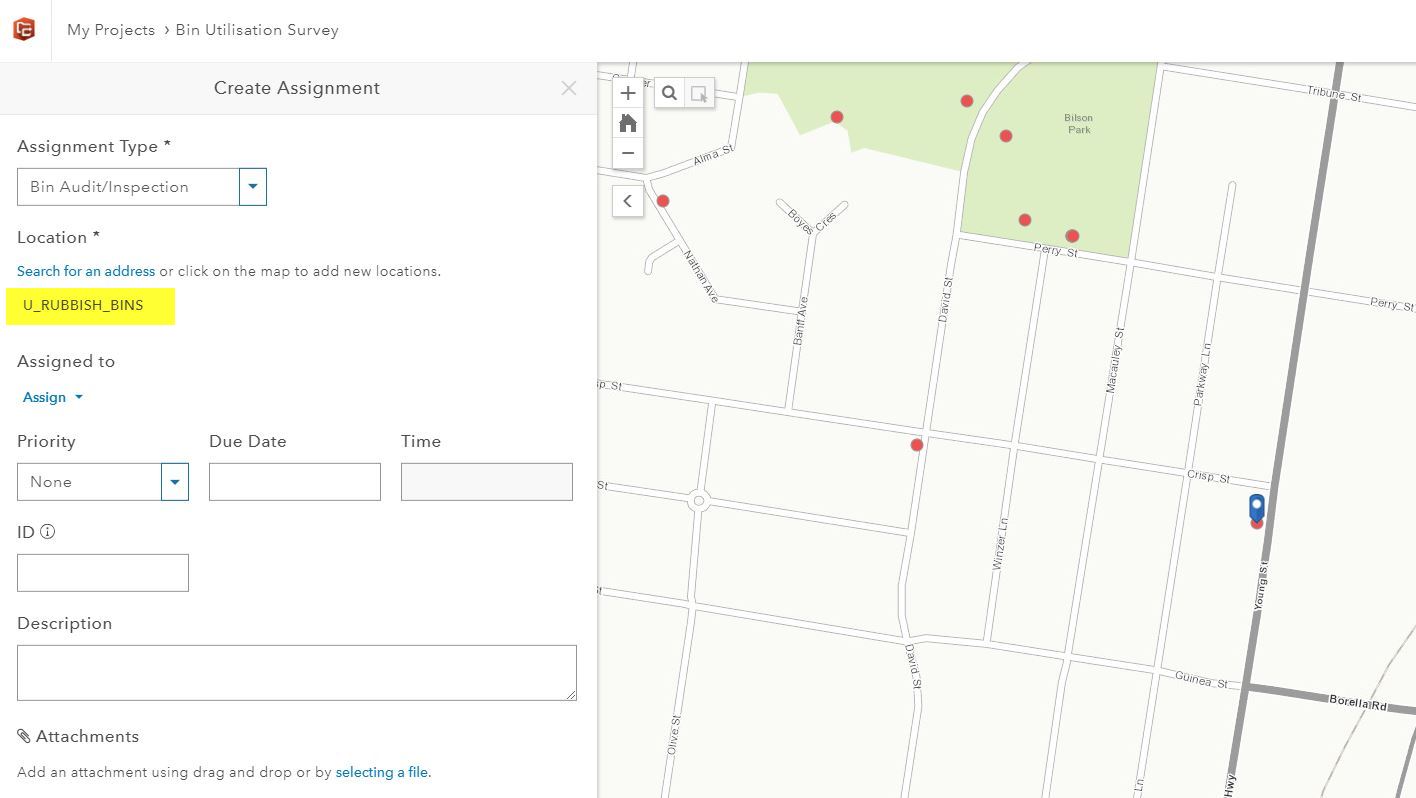

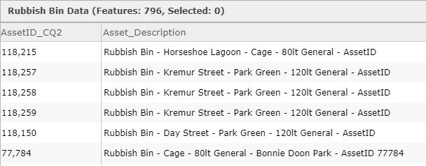

I have just created a feature layer online, and this feature layer has hundreds of features, and there is about 20 attributes in this table for each feature.
I want to select a feature on the web map, and assign the task to a worker. When I select a feature and click create assignment, it auto populates the LOCATION field with the feature layer name. I am wondering if I am able to modify what data is inserted here, as I would much prefer to pass an assetID accross.

The location field in Workforce when creating an assignment uses the Pop-up title for that particular feature layer from the Workforce Project web map. If you add the assetID field to the pop-up title, it should pass through when creating an assignment.
Check out the Project Creation Tips > Tip: Customize feature pop-ups here:

BenVan_Kesteren1
Deactivated User
Hey, Thanks for the detailed reply.
Yeah it seems to have eventually worked fine, but it was not applying the changes instantly for some reason. It wasn't until I came into work the next day that the changes filtered through entirely.
