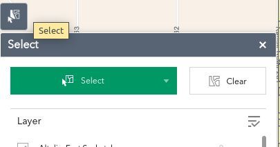

GregPommen
I think I've got kind of a solution.  Create a web application, then use the Select widget.
I don't know if this widget is available everywhere, but in my organization it is.  This way you can select multiple features, and look at the selected info in the Table as well.
Hope that helps.
