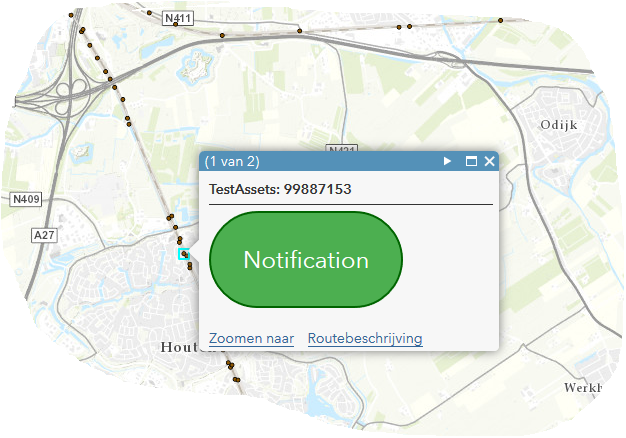

I would like to trigger a Survey123 survey from a popup window in a web map. For this I would like to offer the end user a clickable button in the popup (see figure 1).
I created the button using the code below.

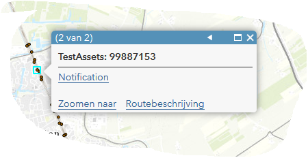

But when I save the web map and reopen it, all that is left is a simple hyperlink (see figure 2).
What do I do wrong? Why is the configuration of my button not properly saved in the web map?

I'm not sure about getting your code to work (Actually, looks like <button> isn't supported: Supported HTML—ArcGIS Online Help | Documentation ), but ESRI created this popup configuration for the Election Management solution that has two big buttons in the popup that open surveys and works well for me:
