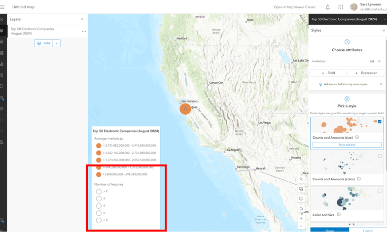

I have a web map in AGOL and I'm using the clustering aggregation option to visualize my data by categories (with a unique symbols symbology). The category part of the legend with the colors looks fine, but there is this "Number of features" section (showing the graduated size of the symbols) that I want to get rid of. Is this possible to do?

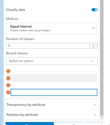

Go to style > classify data and change the labels.
You can add a space (' ') to effectively remove the labels.
Just keep in mind users won't know the size the circles represent.

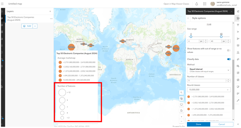

I am actually having the same issue as well! There doesn't appear to be a way to remove the "Number of Features" from the legend. It only appears when I am using the Aggregation > Clustering option
It's also a little confusing to readers, because if you Zoom in an out of the map - it will eventually show duplicate symbology. I suspect it is trying to be a dynamic Legend as you adjust the map, but it gets stuck:
