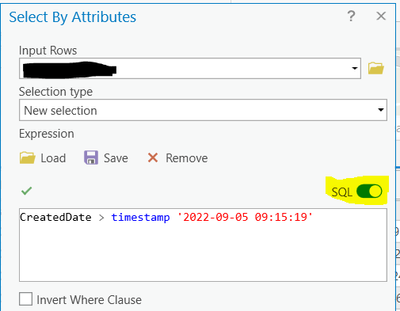

If you open up your APRX and use the SelectByAttributes tool and add a query on the date field, check the SQL button (highlighted in yellow) and you will see the format that the SQL query needs to be in for a date field. Similar to below.
Your query will look similar to
"CreationDate > timestamp '{0} 00:00:00'".format(tStamp)
Where tStamp represents the date as YYYY-MM-DD
or
"CreationDate > timestamp '{0}'".format(tStamp)
Where tStamp represents the date and time as YYYY-MM-DD HH:MM:SS
