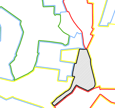

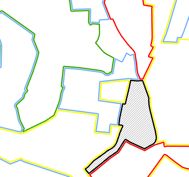

I digitized an old redline map on ArcGIS pro. I symbolized each zone with a color outline that represents their ranking. I need to see layers beneath it so there is no Fill. I offset the outlines of the polygons to keep them from overlapping. If they overlap it is hard to distinguish the zone ranking.

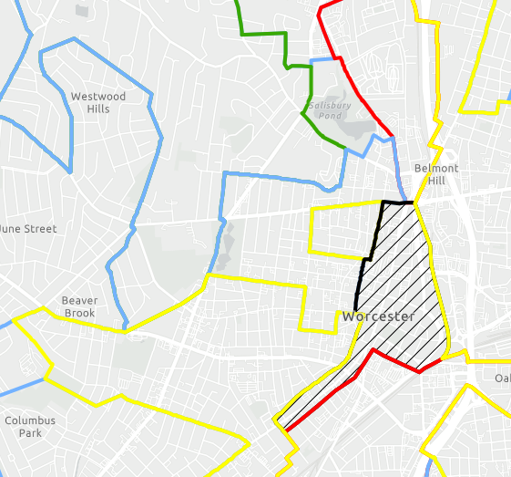

When I uploaded the layer to ArcGIS Online, the boundaries were no longer offset. I tried changing the layer layout settings but found no option to offset outlines. Although you can change the width. Anyone have any workarounds or know a solution?
