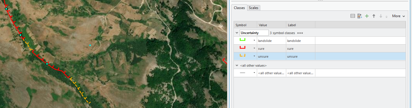

I created the symbology in the picture in ArcGis Pro and I would like to import it in ArcGis Online.
Since it is a composed symbology when I upload the project online (Share > Web Map), the symbology is simplified to only coloured lines, so is there a way to import the full symbology?

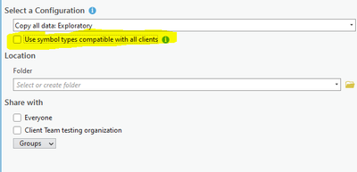

When you share the web map from Pro make sure to uncheck this box
The advanced symbol you are using in Pro will then work in Map Viewer (not map viewer classic) along with other 4.x JSAPI apps like Experience Builder, Dashboards, instant apps and story maps.
