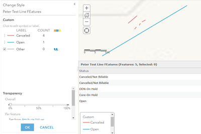

I am trying to group the below attributes where they are all under one attribute named (Cancelled) and change the symbology to black lines.
Is this something I have to do in ArcGIS Pro?
by Anonymous User
Not applicable
Hi @Anonymous User, you can do this with Arcade in ArcGIS Online. Choose to style the layer with a new expression, then enter something like the following:
if ($feature.STATUS == 'Canceled/Not Billable' ||
    $feature.STATUS == 'Cancelled/Not Billable' ||
    $feature.STATUS == 'ODN-On Hold' ||
    $feature.STATUS == 'Core-On Hold') {
    return 'Canceled';
} else return $feature.STATUS;
Result:
Hope this helps,
-Peter

Thanks so much, this helped with multiple problems I was having!
