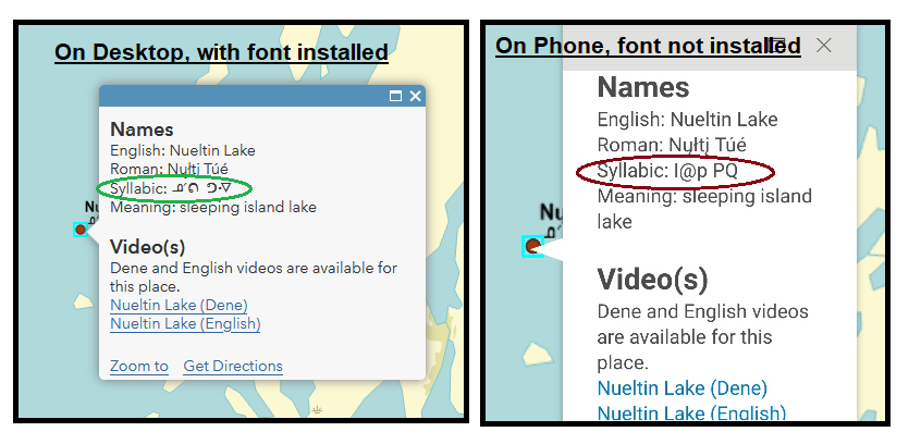

I have a web map where I would like to include an Indigenous syllabics font in the popup. My current method works fine until you open the map on a device that does not have the font installed.
This is by simply working in the popup under html for the Custom Attribute Display. Here is the bit that tells the font to display in those syllabics:
<font face="SayisiDS">{Syllabic_G}</font>
Where "SayisiDS" is the name of the font installed on my desktop and "Syllabic_G" is the field name for the attribute in the point file. The curly brackets seems to be what tells the code that this is a field name.

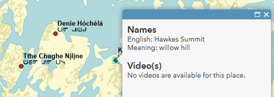

I was still unable to find an answer for this. I decided to remove the Syllabics and Roman names from the popup, leaving only the English and other notes.
The Syllabics and Roman were already included as labels baked into the basemap tiles. How I managed that would be a whole separate post. But it seems the best for now is to have labels in a custom basemap, not in the popup. An acceptable workaround, I guess.

I'm out of ideas for today. As far as I can tell the only solution remains that the client viewing the map must install the syllabics font.
