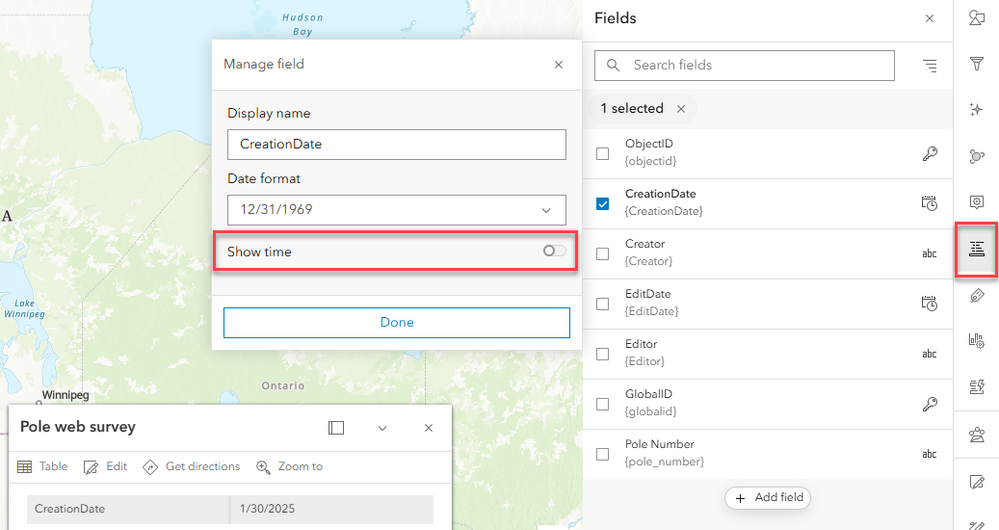

Hey @SanchezNuñez
If you go to the fields window on the right hand side, you can configure this after selecting the field shown here:
Just flip the show time to the off position and you'll be set!

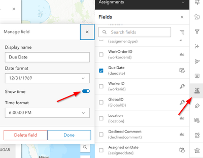

JenniferAcunto
In the fields tab, select your date field and then untoggle Show time.
