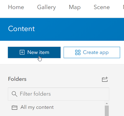

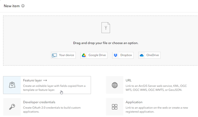

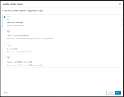

You can do this by going to My Content, and adding a New Item. You can select the Feature Layer option to create a point with minimal attributes. Make sure editing is enabled.
Once that new layer is added to the map, you can use Edit to draw points on the map.
That layer can then be used for analysis.
