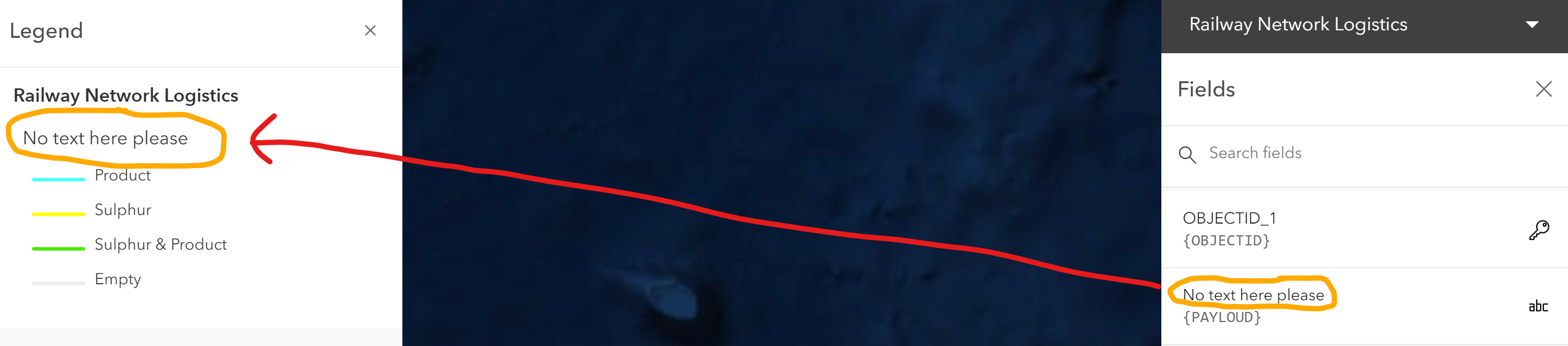

I dont want the field heading to display text in my legend for my webmap.
If I delete the text for the Field Heading under Fields on the right, the Field Name is used in the Legend.
Is there some code that will display a null value heading and not show anything in the legend?

I discovered what I think might be a hack and probably not proper but works great for that. If you go into “Configure Popup” for that layer and even if you have done a custom popup go into “Configure Attributes” and delete the Field Alias in the popup definition. As I said, I am pretty sure this is not how it is intended to work but it works for me and I use it regularly for the education materials I am working on. Let me know if it works for you or if I wasn’t clear in my explanation. Two screenshots included.

I tried looking for where I can remove the alias but I cant see the same area in 'Configure Popups' like you are.
I see you are using the classic viewer while I am on the new 'Map Viewer'
Does it look like I am in the right area (attached)?

Yes, my hack is for Map Viewer Classic. You may be able to open your map in Classic, erase that heading in the Popup configuration and save the map. Then open the map up in the new Map Viewer and see if that configuration stuck. I’m 50/50 as to whether it will but it will take only moments to test.

Yes I switched back to Classic Map Viewer and found where you could edit the alias.
I removed the alias, then switched to the New Viewer and the alias was still there!
I guess the only resolution to this is publishing the web layer again from Pro without an alias.
