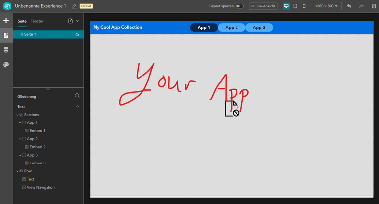

I made this quick (and ugly) example in 5 minutes:
So basically, use a Section widget. For each app you want to include, make a new View in the section widget adn create an Embed widget pointing to the app's URL.
Create the top bar using a Row widget, insert a Text widget for the tile, and a View Navigation widget for switching between the apps.

JenniferAcunto
I agree Experience Builder is the way to go. If you want more of a 'landing page' look for your start page, you can give each app their own page using the embed widget and a home page with images, links, or icons to navigate.
I would then include a header on all of your app pages with a menu for easy navigation between apps.

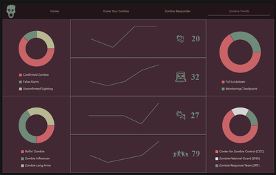

AndreasHall
Experience Builder is a great option! Another alternative that could be worth looking into is the Category Gallery Instant Apps. Here is an example application: National Parks Data Gallery (arcgis.com)
