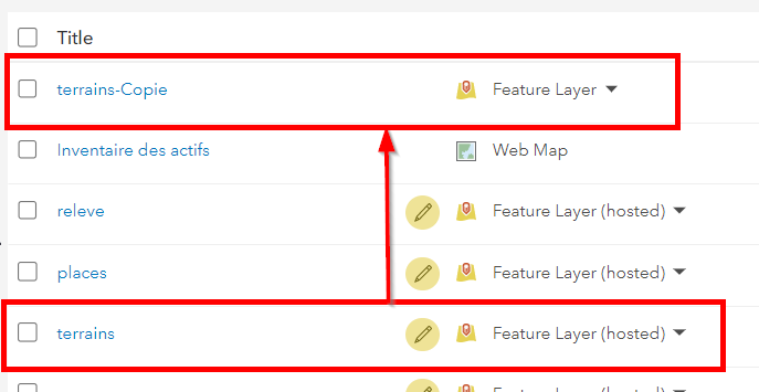

I'm trying to create a duplicate of an existing hosted feature layer, but when I do, this layer is then considered a "feature layer", not "hosted". How to convert this feature to a hosted one?

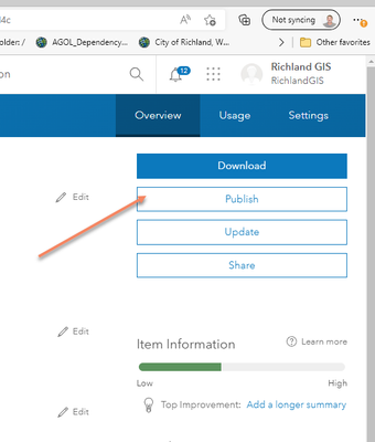

Then, open the item details of the newly created FGBD and select Publish:
You will now have the data duplicated as a new hosted feature layer.
