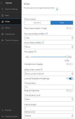

Hi @ElizabethHale1 ,
No need to make a view.
When you create an instant app with slider from your webmap, it is possible to have this behavior. Be aware of the second interval length, there you can set the time steps within the total time duration.
