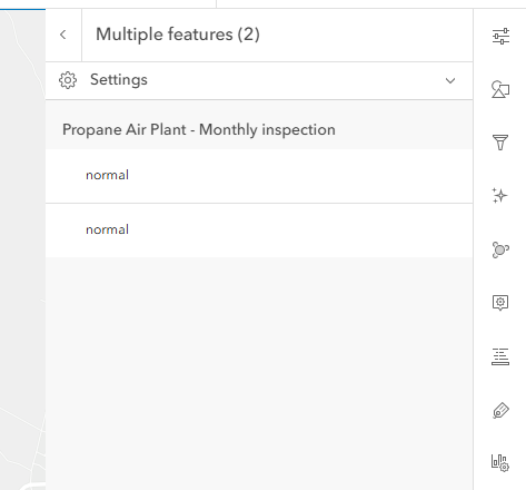

There must be a really simple answer to my question but I can't seem to figure it out. When you are editing in Map Viewer and you have multiple features from the same layer selected, a list of those features pops up, and I'm trying to figure out how to change the way those features are labeled.
In the screenshot below, my features are labeled based on a useless field that will show "normal" for almost every single feature. I'd like to change which field is used, such as inspection date and/or inspected by.

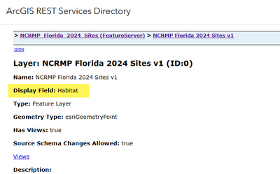

and this is what the Rest service shows

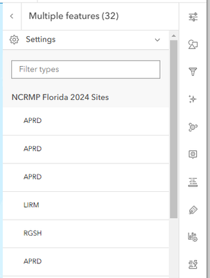

When I edit it, all the points show the Habitat field
