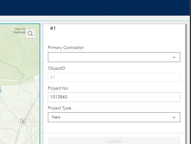

Hello,
I am attempting to change the default "Display Field" for some layers hosted in ArcGIS Online. Most of these layers were published from Survey123 Connect. Specifically, I need it changed in the Experience Builders Edit tool (screenshot below) - but I have seen other areas that would benefit from being able to change the value.
The default seems to be ObjectID, and altering the pop-up in Map Viewer does not migrate over to the Edit tool.
I have changed the field order using ArcGIS Online Assistant, putting my preferred field at the top of the list, but it did not change the Display Field. Is there a specific line item I can add to the JSON file? Or am I missing something very basic here....
Thanks!
KPyne
Update: I discovered displayfield within the "Update Definition" of the REST services in admin mode.
I was able to update the value there
