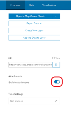

1. have you enabled attachments in AGOL yet?

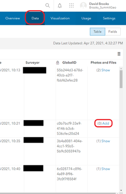

3. But if you're looking to do this in AGOL, you can add attachments via the Data tab from the Item Description menu:

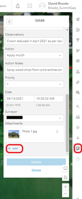

4. Or if in a web map, you can edit features or add features and add attachments from the editing popup:
